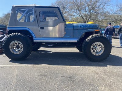

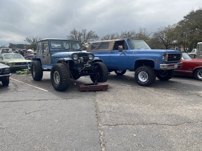

So, we took the #RenegadeCJ down to the dirty myrt this last week for the 34th annual Run to the Sun. Had a lot of fun cruising the beach in the only trail rig out of probably 4,500 classics in town. It got a ton of attention to say the least... maybe some from the squeking belt...lol.
Friday morning my cooling fan decided to go to be with the lord. It self destructed but luckily didn't snag the radiator. Going to use this as an opportunity to upgrade the already questionable cooling system before Harlan.
I bought a 3K CFM fan at the show and wired it up wrong in a hurry....oops. Going to get the Flowkooler high volume water pump as I think my water pump is the culprit of the squeak. Going to do a flush mount aluminum shroud for the newly acquired fan and see how it does. Hopefully I can take the pusher out of the grill as I hate how it looks.
See youins in Kentucky next month. Some Dirty Myrtle pics until then....
